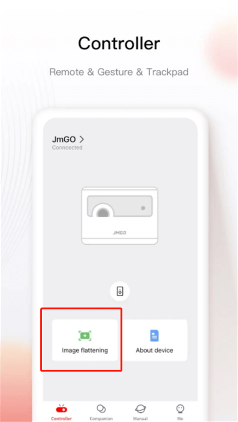

1. Pair JMGO O1 with the JMGO App (make sure both your smartphone and JMGO O1 are connected to the same network).
2. Go to "Image Flattening" in the JMGO App.
3. Take a photo of the projection screen, hit the "Use Photo" button, and the screen will correct itself.
