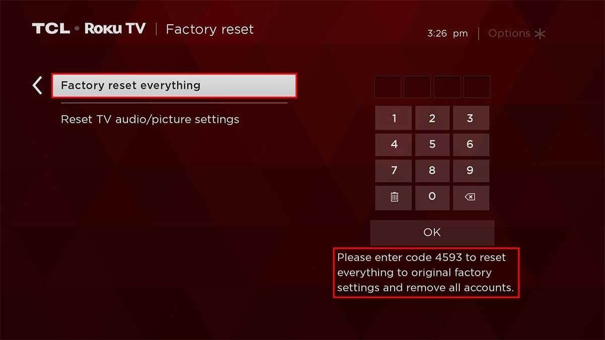

Reset your TCL Roku TV​
You can try resetting your TCL Roku TV to factory settings. This will clear all login information and data and restore your device to its factory defaults, so make sure you back up your important data.
1. Press the remote Home button to go to the Home screen.
2. Select Settings.
3. Scroll the remote control to select System.
4. Navigate to Advanced System Settings.
5. Select Factory reset.
6. Then click Factory reset everything.
