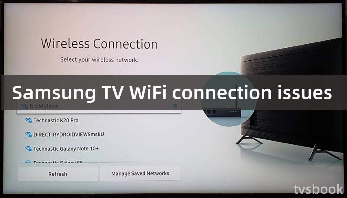

If your Samsung TV keeps disconnecting from WiFi, you may notice the following error code on your TV.
  • Message code: 0
  • Error Code 001
  • Error Code 012
  • Error Code 102
  • Error Code 105
  • Error Code 107
  • Error Code 13
  • Error Code 116
  • Error Code 118
  • Error Code 301
  • ERROR_MODEL_BIND
  • Error Code 0-1
  • Error Code 7-1
