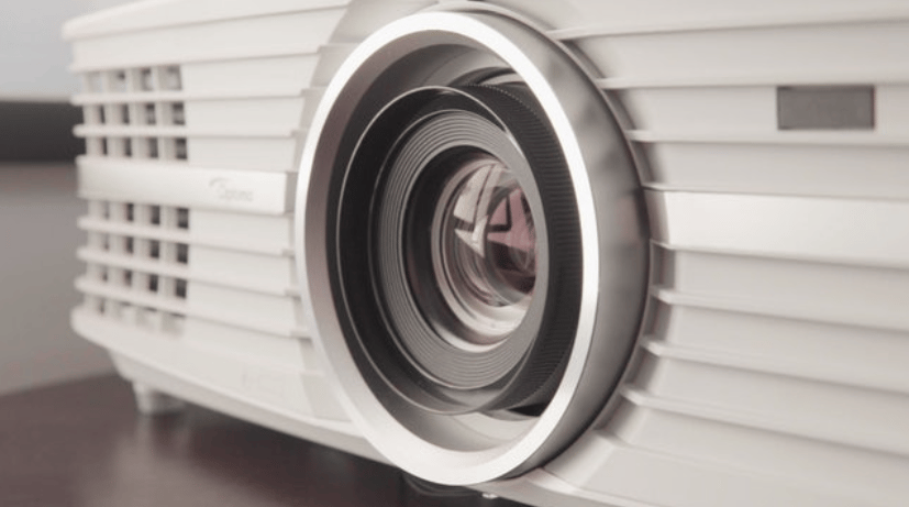

If your projector's brightness is too low, you can replace the projector's light bulb; disassemble the unit and clean the projector's optical lens; close the curtains or turn off the lights to reduce the interference of ambient light on the projector's brightness.
Projector not bright enough, what should I do?​
1. The light source of the projector comes from the lamp inside the body. After the projector has been used for a long time, the light brightness of the bulb will decay. So when the projector brightness is not enough, you can replace the projector light source bulb with a new one.
2. The light machine of the projector is the core component of the projector, and the projector light machine has many lenses inside. If too much dust accumulates on the lenses will affect the brightness of the projector's light path, cleaning the lenses in the light machine can also make the projector brighter.
3. reduce the interference of ambient light can improve the brightness of the projector. Because the projector is diffuse imaging, so the brighter the outside ambient light, the lower the brightness of the projector's picture will be. Therefore, when using the projector, please draw the curtains or turn off the lights.
