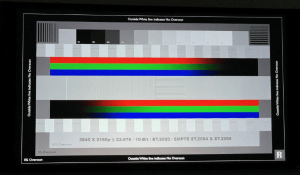

Optoma UHD52ALV 4K Projector uses 1920 × 1080 points (Full HD resolution). This active part will be shifted at high speed 4 times so as to be able to obtain a UHD resolution of 3860 × 2160. So it is by no means a native UHD or 4K resolution but a simulation, as for all its competitors. The 4K target displays its white rectangle at the edges furthest from the center of the image. This characteristic makes it possible to observe that the video processing internal to the projector does not cut out parts of the work that you are projecting.
Overscan Optoma UHD52ALV

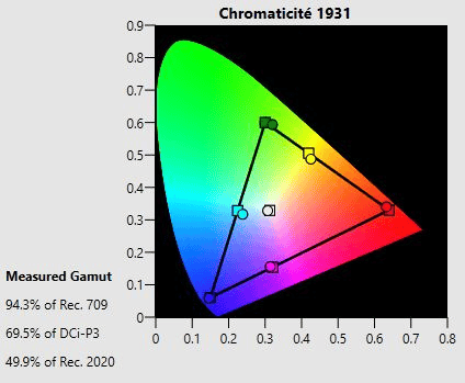

Color / contrast and brightness:
Out of the box, the best results are obtained with the cinema selection which offers a color temperature of 6257K with a deltaE difference of 6.15 and a gamma of 2.2 although linear.
- CIE cinema out of the box Optoma UHD52LVA
- CMS advanced cinema out of the box Optoma UHD52LVA
- RGB Gamma Cinema out of the box Optoma UHD52LVA
A DLP like this is not capable of producing a wide range of colors as we can see in the results, it actually follows a Gamut lower than Rec.709, the fault of its color wheel with white segment and the use of a UHP lamp.

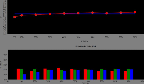

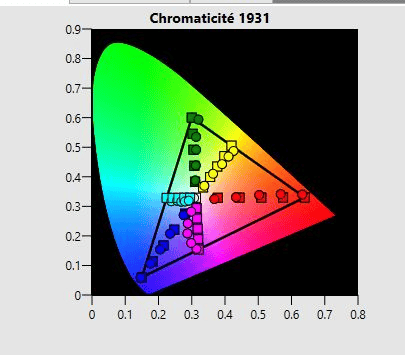

After calibration I reduced the deltaE difference to 2.44 (that's perfect because below 3 the human eye cannot perceive the difference).
CIE post calibration Optoma UHD52LVA
Advanced post calibration CMS Optoma UHD52LVA
RGB Gamma post calibration Optoma UHD52LVA
