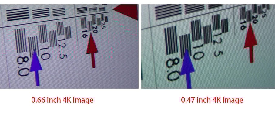

Although both achieve 4k resolution, the 4k resolution displayed by the 0.47 and 0.66DMD chips is different. Compared with the 0.66DMD chip, the 4k picture quality of the 0.47DMD chip will be blurred and the graininess is stronger, and the 4k picture of the 0.66DMD chip will be clearer and more delicate.

The real physical resolution of the 0.66-inch DMD display chip is 2716*1528, about 4.15 million pixels. Through XPR dithering technology, a displacement is performed in the diagonal direction, so as to achieve effective pixels * 2, reaching the standard of 8.3 million pixel display.
The real physical resolution of the 0.47-inch DMD display chip is 1920*1080, which is also shifted by XPR technology once up and down, left and right, and finally achieves effective pixels * 4, obtaining 8.3 million pixels, reaching a resolution of 3840 * 2160.
