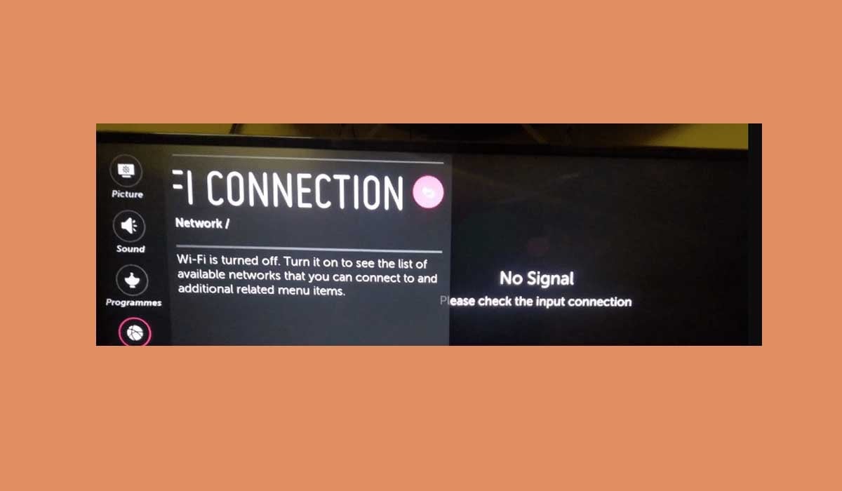

This article will show you how to fix LG TV says WiFi is turned off.
LG TV is one of the most popular TVs on the market, and its premium quality and advanced smart features have attracted many users. You can experience a variety of apps and streaming services using the LG Smart TV operating system, but all of these smart features require your LG TV to be connected to a high-speed and stable Internet connection.
When your LG TVsays wifi is turned off, your experience will be greatly diminished. Fortunately, you can troubleshoot the problem with this article to quickly fix the error to resolve the WIFI turned-off issue.
Why my LG TV says WiFi is turned off?​
If you want to use the smart features of your LG TV, you'll need to connect your TV to a WiFi network. There are many reasons for not being able to access Wi-Fi from your LG TV, which can usually be resolved by restarting the device, while other software or hardware failures will require other fixes.

First, you need to check if you have turned on the WiFi on your LG TV.
1. Press the Home button on your LG TV remote control.
2. Click on Settings.
3. Navigate to Network.
4. Select Wi-Fi Connection.
5. Select your Wi-Fi name from the list and enter the password to connect.
If you have followed the above steps to turn on the WiFi connection, but your LG TV cannot connect to the network, please follow the options below to fix the problem.
