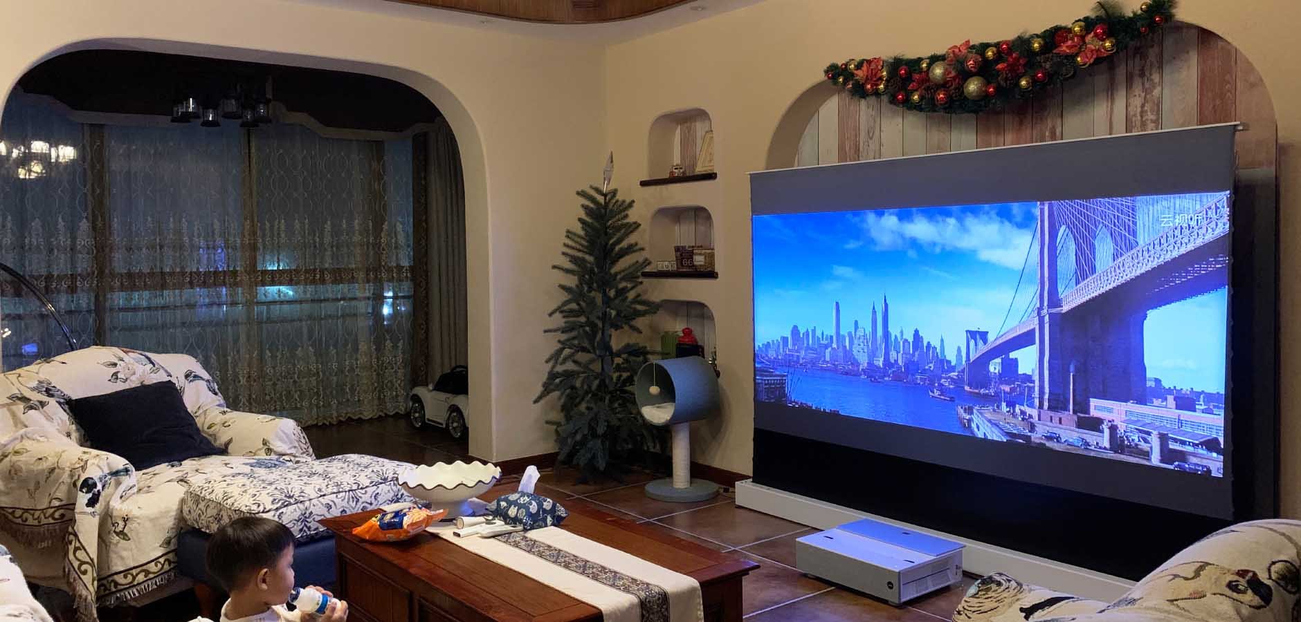

Projection screens are used in movies, offices, home theaters, large conferences and other occasions to display images and video files. Divided into many specifications and sizes.
The selection of projection screens in different spaces is also different. For example, when there are many people watching or viewing horizontally, it is better to choose a screen with a wide viewing angle and low gain. The screen helps to improve the contrast of the screen, increase the gray scale of the image, make the color vivid, and increase the visibility of the image.
(Pic from vividstorm)
