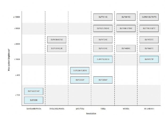

However, delivering high resolution in projectors is no easy task. The core of a projector is its digital light valve chip, which is typically very small. For instance, mainstream DLP 4K projectors use a 0.47-inch light valve. Achieving 2K resolution on such a small chip is already challenging, and 4K requires pixel-shifting technology. For 8K, a native 4K light valve chip of around 0.8 inches is needed, combined with pixel-shifting to simulate 8K resolution.

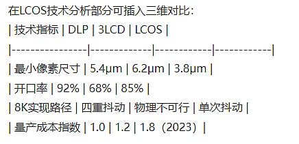

Over the past two decades, DLP's smallest physical pixel size has remained at 5.4 microns, limiting its resolution capabilities. LCOS technology, on the other hand, offers smaller pixels (down to 3.8 microns), enabling 4K resolution on chips smaller than 0.7 inches. Meanwhile, 1LCD technology, which dominates the entry-level market, requires large 4-6 inch panels for 4K, while 3LCD struggles with pixel miniaturization due to "aperture ratio" limitations, with its smallest pixel size currently at 6.2 microns.

Currently, a small number of 8K projectors are available, including both pixel-shifted and native 8K models. Notably, native 8K projectors almost exclusively use LCOS technology. This is because LCOS offers the smallest physical pixel size, giving it a natural advantage in the ultra-HD era. While LCOS has historically played a minor role in the projection market, its potential is now being unlocked.
Additionally, LCOS chips can be smaller in the 8K era, reducing core costs and enabling more compact designs. Both factors will help drive adoption and application development.
