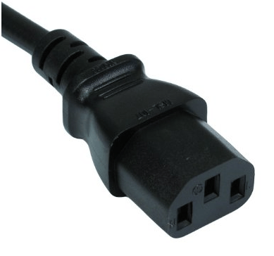

NO, Not all LG TV cords are created equal, but generally only four types are used and they are easy to tell apart.
In general, monitors that require higher current will use a "kettle lead"* IEC C13 or similar.
power cord on lg tv
For LCD/LED type TVs with lower power requirements but still requiring a detachable power cord will use a right angle or right angle format "figure 8"* cable IEC C7
