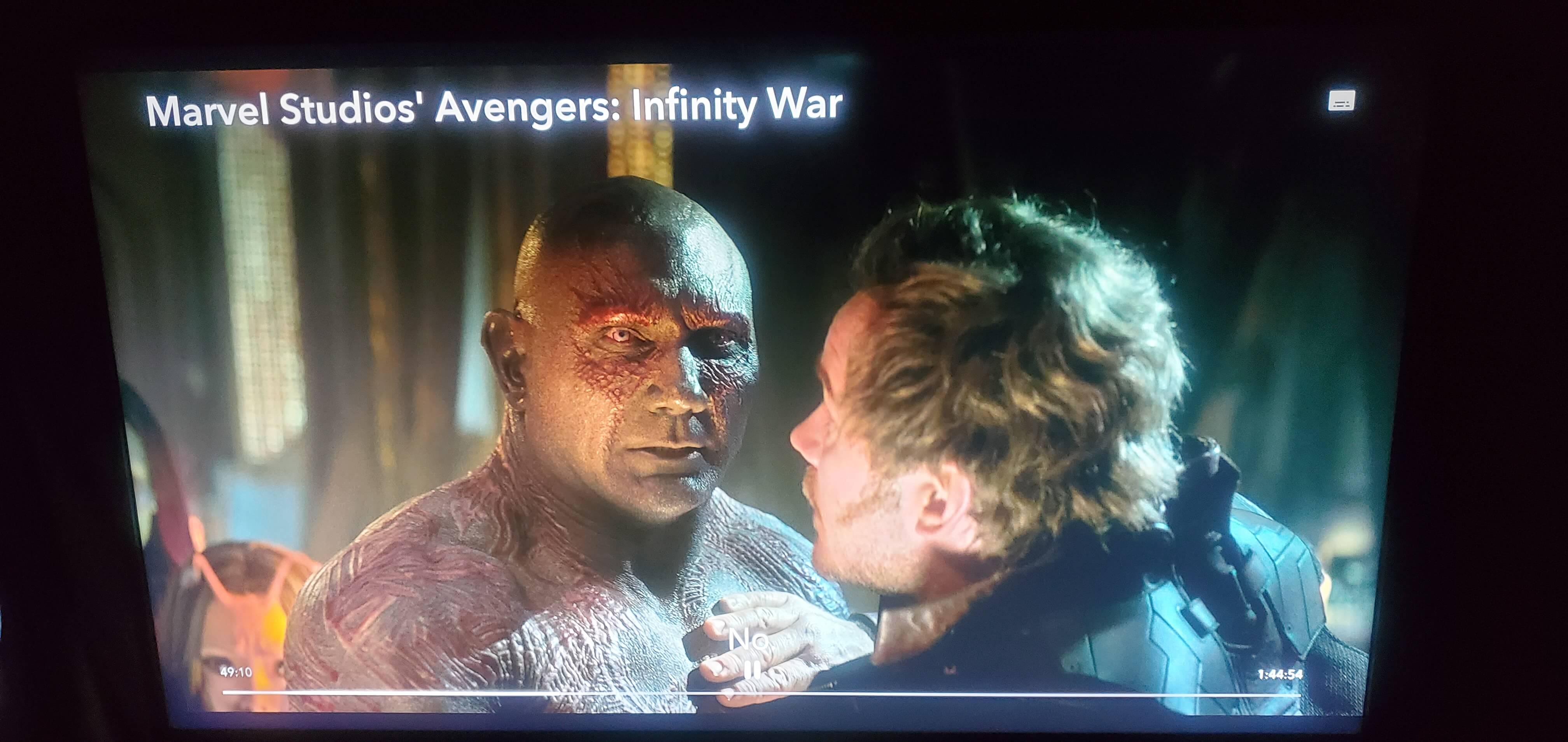

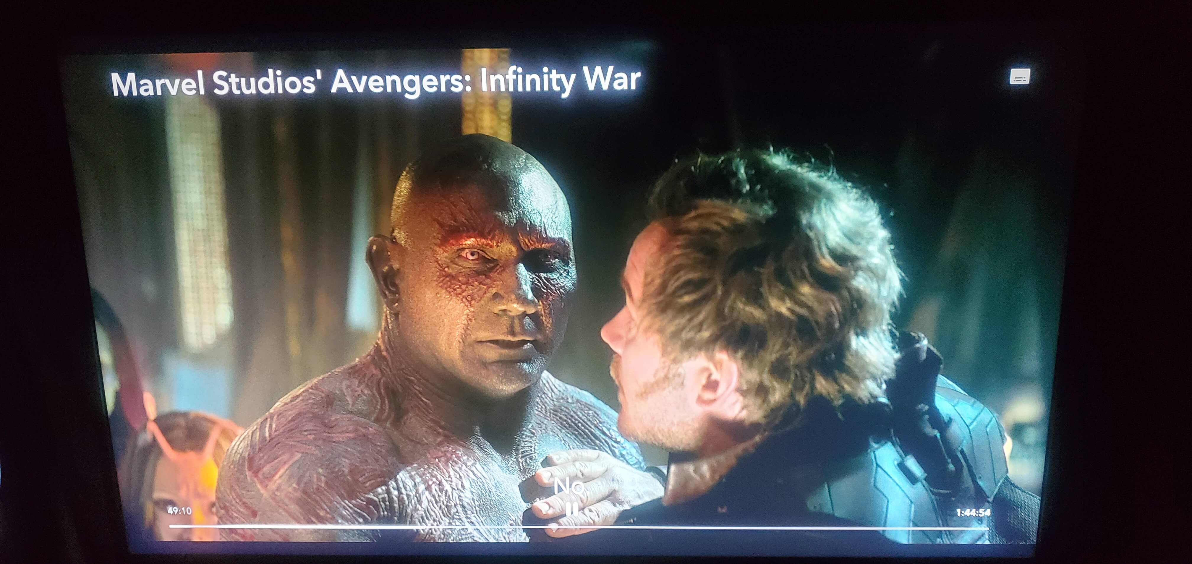

Just got this TV for a deal, all it needed was some backlight repair. Powering it on, the backlights were clearly not working but the screen was fine. After some voltage reading I was pretty sure it was the power board that was bad so I replaced it. That seemed to fix it temporarily but now the rows of lights seem to be dimming individually. Do I need to replace the light strips now or if this something worse?
